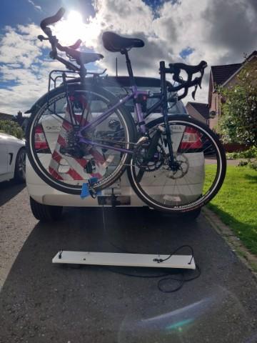

Hi Cliff - In case it's any help, on our motorhome tow ball we use a Thule clamp on bike rack to carry the bike horizontally across the back of the vehicle with the front and back wheels removed. We don't have racks or mudguards on our bikes so they just fit within the vehicle width. Depending on your car and bike dimensions and specs, it might work for your situation. Chris

Hi Cliff, we used to have a Pendle 6-bike trailer, which had a tandem attachment, that allowed up to two fully assembled tandems to be carried along with solos. While this was good when our children were younger, we found it rather poor taking just the tandem. The trailer was quite bouncy due to the light weight. Also it was quite large for storage, difficult to manoeuvre without bikes on it as you couldn't see it and on its own, quite heavy to push around. I think tow ball mounts with a tandem that splits would be the ideal solution, but perhaps not the cheapest if it means changing your tandem.

I agree with the towbar bike carrier option. I used to have a Pendle "behind the tow ball" bike carrier suitable for 4 bikes and carried a tandem mounted diagonally with the front wheel removed. The various tube joints on a tandem frame make this quite an easy option to secure it at around a 45 degree angle.
