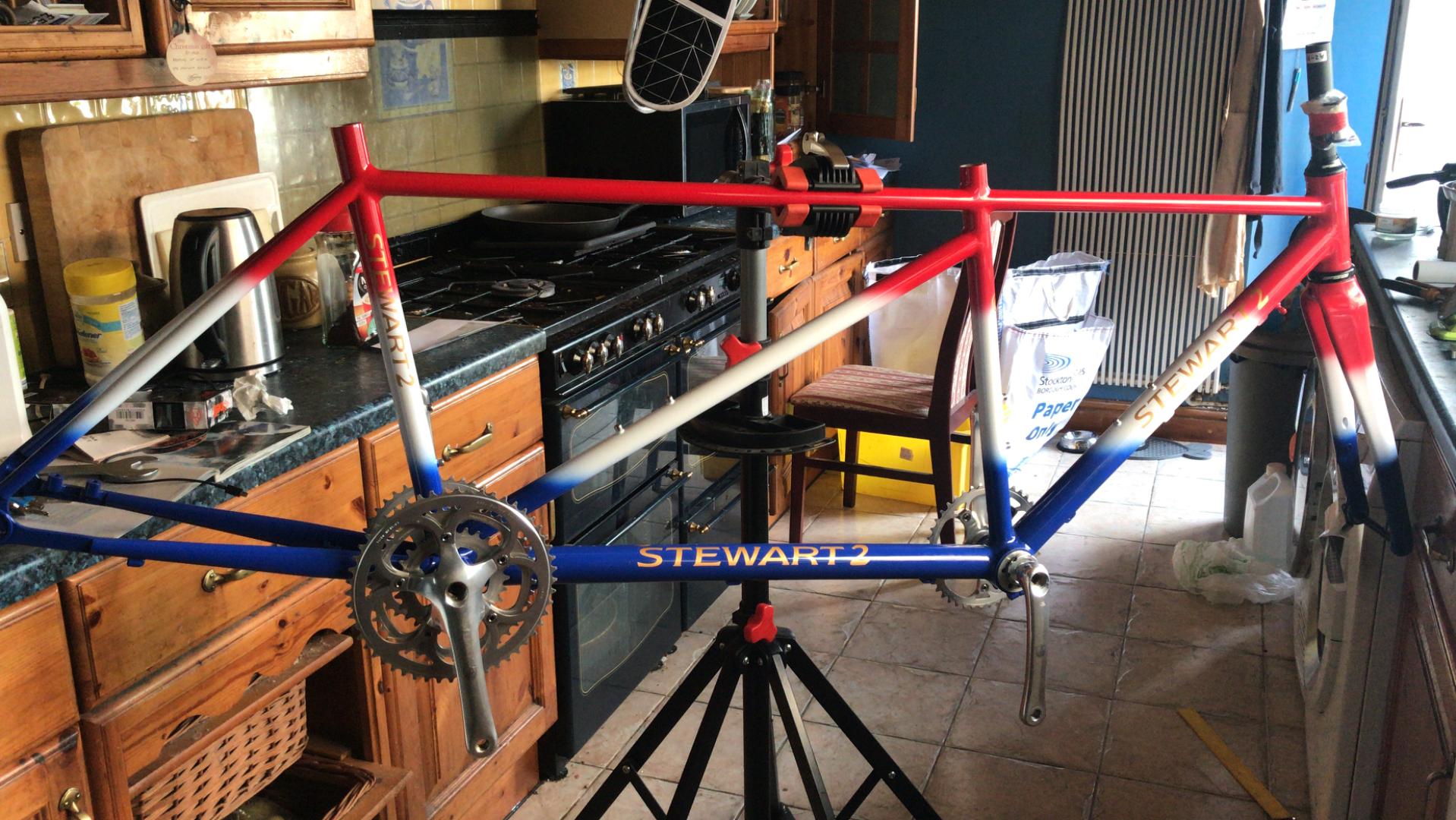

Ive built a tandem frame with the expert guidance of Jeff Roberts at his frame building academy
Its getting hydrolic disc brakes.
I'm asking advice on what are the best sized rotors for both from and rear brakes.
Thanks in advice for any help

Roy Stewart2026-02-08 13:25:39
Thanks for your input guys.
You have given me an idea of what I need.
I'll see what fits the frame and go from there,
Ill' be mostly using it in the UK to do Lands End to John O Groats next year.
Cheers
Roy
Photo of frame attached
