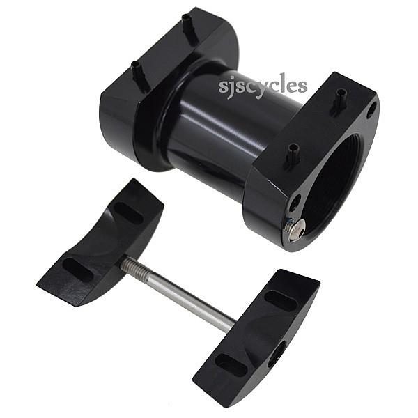

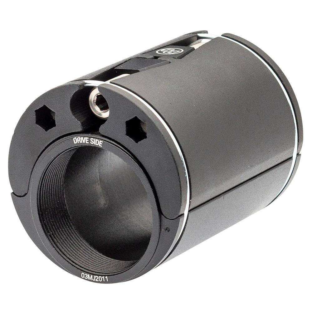

Looks like there are two types with a wedge action to lock the eccentric.
Cannondale 1FG https://www.sjscycles.co.uk/bottom-brackets/eccentric-bottom-bracket-insert-double-wedge-fits-cannondale-rohloff/
Or Bushnell https://problemsolversbike.com/products/bushnell-eccentric-classic-bottom-brackets
Follow the links to see pictures of each type.

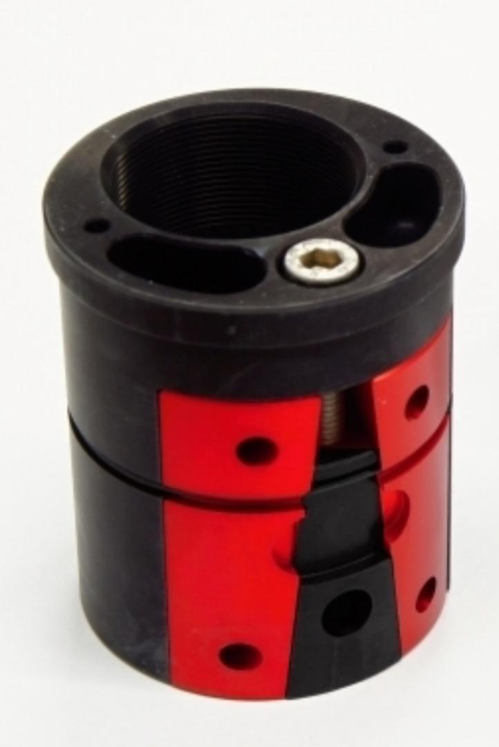

This is the design of Pete's bottom brackets
You need to undo the Allen key bolt and then hit the end of the bolt with a mallet to free up the shims inside. I had to hit ours pretty hard to get it to come loose!
https://www.duratec.cz/en/techinfo/technology/eccentric-bottom-bracket/
