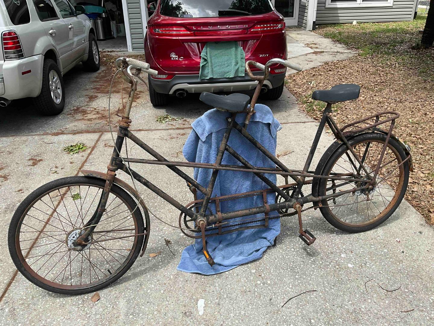

I am restoring a 1937 Fongers tandem with Sturmey-Archer drum brakes.  I need to replace the rear brake cable itself but for the life of me I can't figure out how they assembled it to begin with. Maybe something is missing or has been changed over the years, i don't know for sure.  Can anyone out there who has a tandem with a similar setup provide me with some close-up pictures I can make a comparison with?  For some reason I can't add more than one picture to this post, so I'll try to add other separately.Thanks!

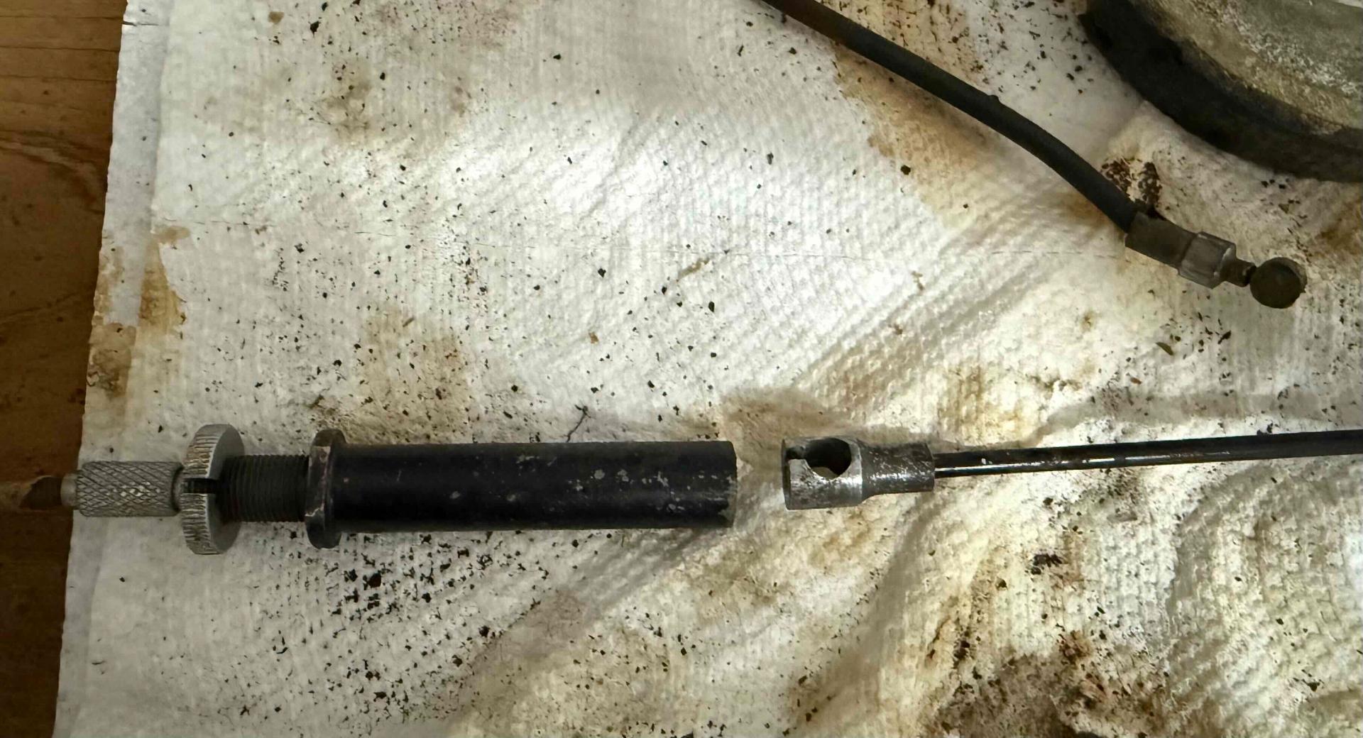

Greg Talamantez2025-06-16 21:36:18
The end at the top of the picture is the brake handle end. The other end is inside the sleeve and connects to the cam on the end of the rod.  But, as you can see, actually taking this apart to change the cable is puzzling. The large threads a the end of the sleeve don't appear to be functional. So again, if anyone has a similar Sturmey-Archer assembly on their tandem, I would appreciate seeing some pictures. Thanks again!
Mark Tipping2025-06-16 23:31:00
Looks more like a connector for a foot brake?

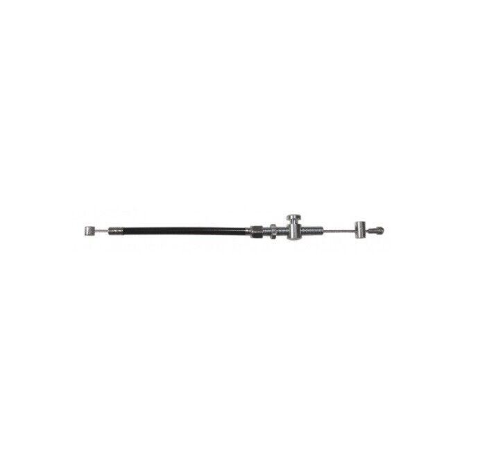

Stuart Hibberd2025-06-17 08:52:36
Looks like Sturmey Archer supply brake cables as a complete unit - cable, outer, adjuster and ends fitted on both ends ready to go.
This is the modern equivalent of what you are looking for I think.
You might be able to adapt a modern cable to fit. Check out the Sturmey website to find the part numbers for the different lengths. https://www.sturmey-archer.com/en/products/brake-levers-and-brake-cables
Edmund Dunstan2025-06-17 09:04:07
There certainly used to be brake cables with an end welded on, so that you couldn't replace the cable on its own - I had a BSA bike with effective roller-cam brakes that I had to discard because I couldn't replace the cable. I'm not sure I'd want to stake two peoples' safety on a blob of lead I'd stuck on myself. Would it be possible to pass the cable through  a bolt with a hole in the shank, as used for fastening brake cables to side-pull or V-brakes, instead?

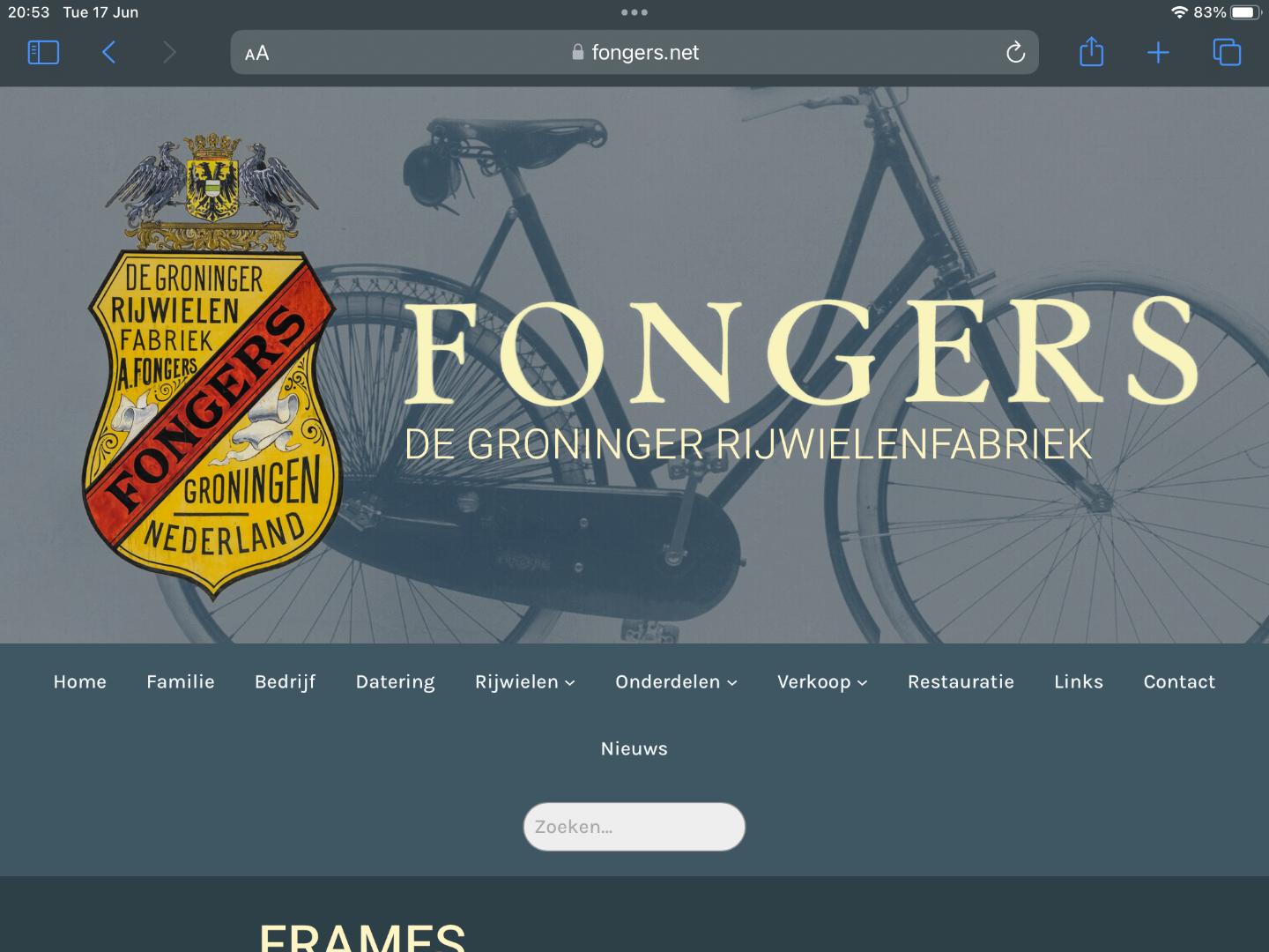

2025-06-17 20:53:45
Have you looked at the Fongers.net website? if you contact them they may be able help.
