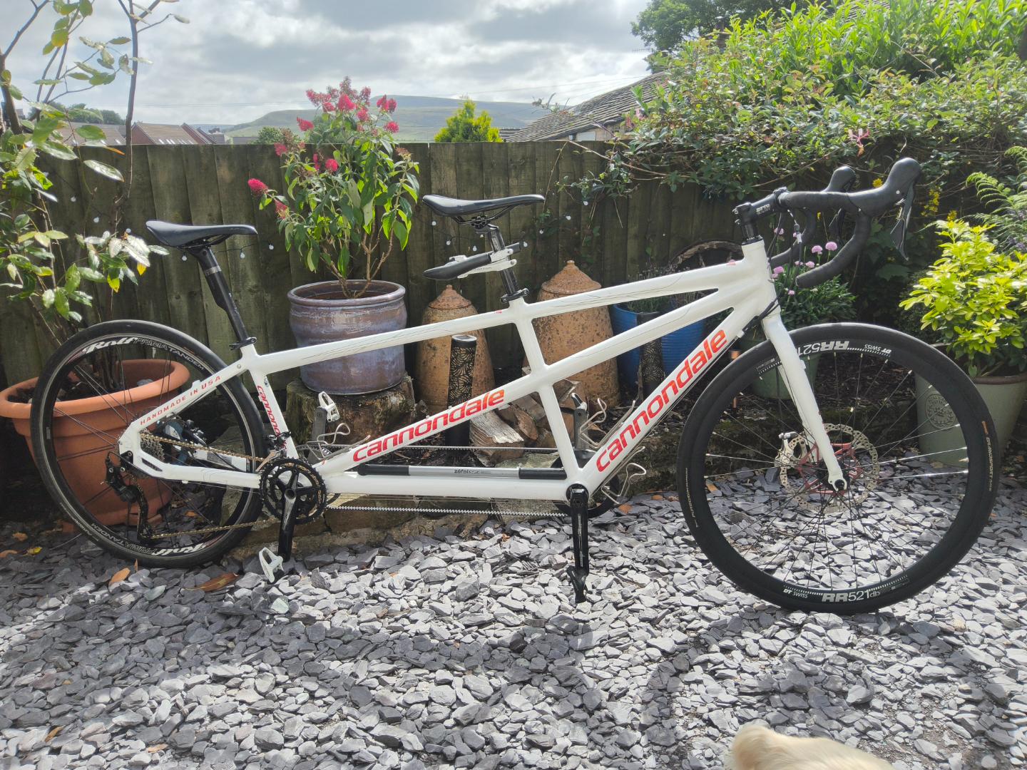

Stephen Carson2025-07-08 09:53:40
An update,
Many thanks to everyone who gave their advice and experience, some really valuable information which has been very helpful
My Tandem purchase ideas where put on hold for a while, Bank of Mum and Dad needed to make some investments :-)
Anyway, a new posting in the For Sale section of this site has led me to a new (old) bike purchase
Many thanks to Michael Brooks (you will notice his post above), I am now the very delighted owner of a Cannondale Tandem.  I had plans to build up a Landescape over the Winter until Michael's post popped up about 2 weeks ago.  We have communicated since my initial enquiry and the bike is now sat in my garage, having made the 200 mile journey by courier yesterday.
The bike is ready to ride for the remainder of the summer, I then have the winter for some tinkering :-)
