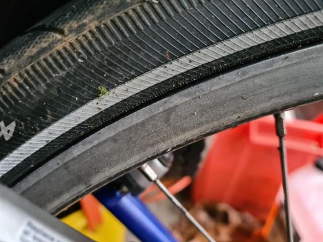

Paul Cooper2023-03-13 16:43:48
Photo of the rim

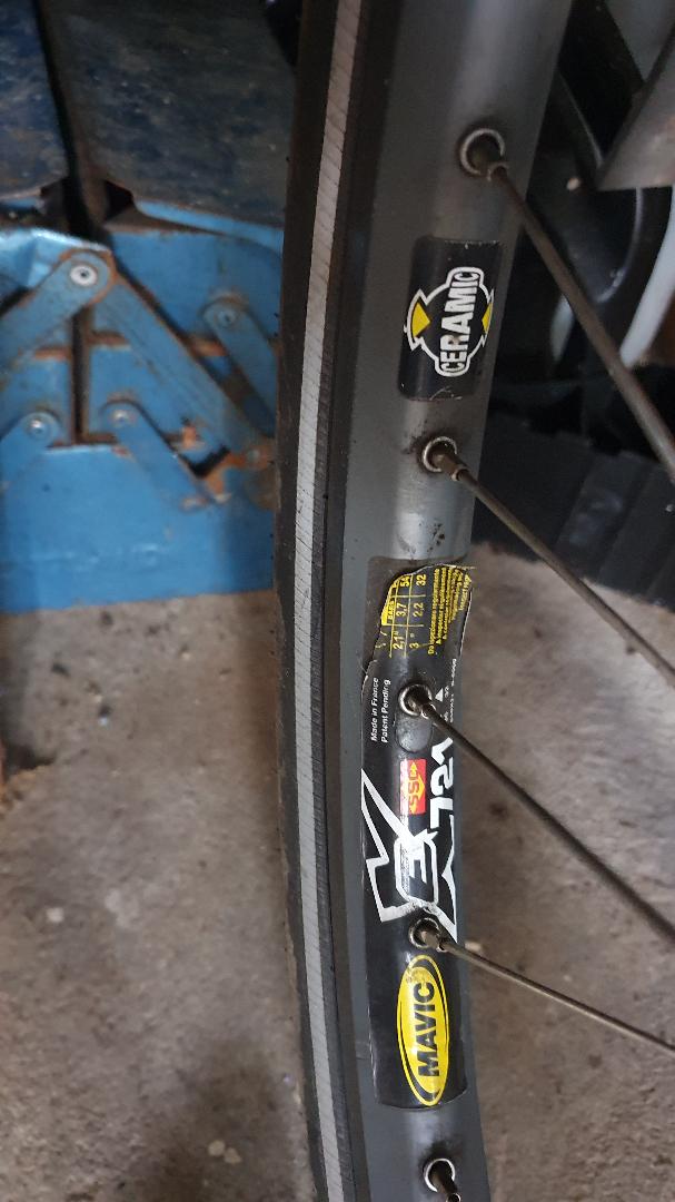

Its probably going to be either a Mavic or a Ryde rim if its ceramic.
Here's the mavic sticker.

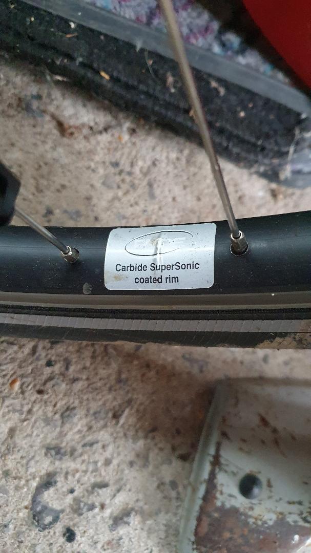

Stuart Hibberd2023-03-13 17:35:53
And the Ryde sticker

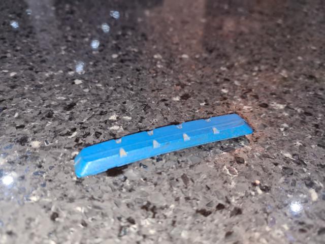

When you say the pads are worn out they don't start off very thick and they wear very slowly. Picture is of a brand new Swisstop Ceramic pad.

In conclusion it looks like ceramic rims with Swisstop pads.
As I said don't use regular pads as they wear out extremely fast.
The pad in your picture looks about half worn.
