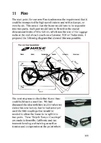

Because we have S&S couplings we always have a fallback position of splitting the bike, which removes anxiety.  However we’ve never needed to do this in Germany.  But to get to Germany splitability is vital, so that one can take the two bagged-up halves across France or Belgium.  Our Pino halves just fit within the regulation “housse” size of 90 x 120 cm which means they can be taken as hand luggage on TGVs.  It it possible to get S&S couplings retrofitted to a steel framed tandem (Kinetics quote just under £1000 to do this, which seems a lot but it will open up huge opportunities).  But you need to check dimensions – see attachment for our Pino.
