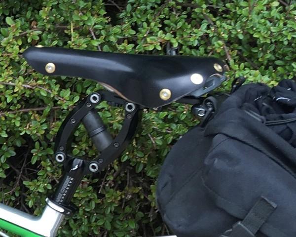

Hi, firstly, with the tandem you have, I'd forget being sporty and concentrate on being comfortable, this equals being able to generate the most power anyway. You still probably have 'sporty' traits from being solo, so did I, I raced for many years. the quicker you realise you have entered a whole different world, the sooner you will be at home on the Tandem. Secondly, some form of shock absorbing seat post for stoking is a must, its night and day. Even when consciously remembering to get out of the saddle, its just not as frequent as on a solo bike, a Thudbuster is the go to for this, taking the sting out of the poor roads we now have. Thirdly, for maximum comfort on any reasonable length of ride, leather will be your eventual end point, so its best to bite the bullet and invest, in place of doing it three saddles down the line, been there, done that! For which type, Giles Berthoud are the ultimate, every part is replaceable, beautifully hand made in France, and Spa Cycles are the cheapest place to get them. Brooks are okay, but quality is not what it used to be and I hear of a lot of failures with old models outliving new ones.
None of the above are cheap, quality that does what its supposed to, rarely is, but don't waste your money chopping and changing until you eventually do end up with these, its false economy. The picture shows a Thudbuster and a GB saddle.
