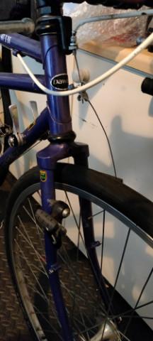

Hi, we have a Dawes Horizon Twin tandem and I'm finding that the cantilever brakes are ... not ideal ... and, as we're intending to race her this year (just for fun) on some lumpy TT courses and I'd like to upgrade the front brake (we hit just under 61mph on a downhill last time out which was ... interesting).
I've popped a photo on the post of the front of the bike.  I know the cable is not connected between the two cantliever arms - she's been in storage for a bit and is needing some TLC before going back out on the road.

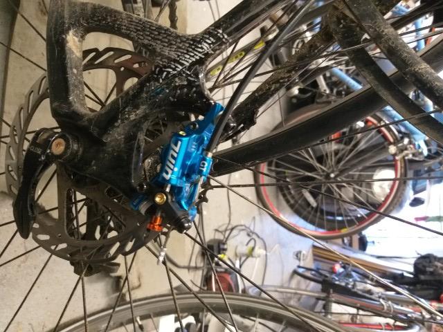

Just on the subject of cable operated disc brakes, on my solo bikes I went through a journey of BB5/7, then TRP Spyre and finally arrived at Juin GT-P 4 pot hydraulic sealed unit/cable operated, which were a complete revelation in stopping power, particularly compared to the previously mentioned cable disc brakes. I did have a bit of a discussion with a tandem bike shop, who were very anti on the basis of the fluid potentially overheating, the brakes failing and a strong preference for TRP Spyre. Is the consensus here in Tandem World the same?

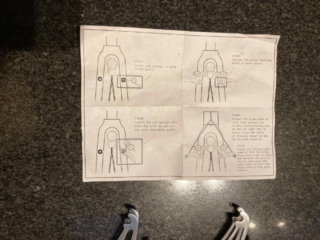

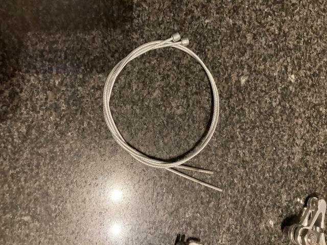

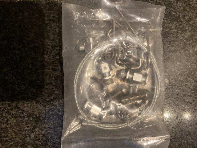

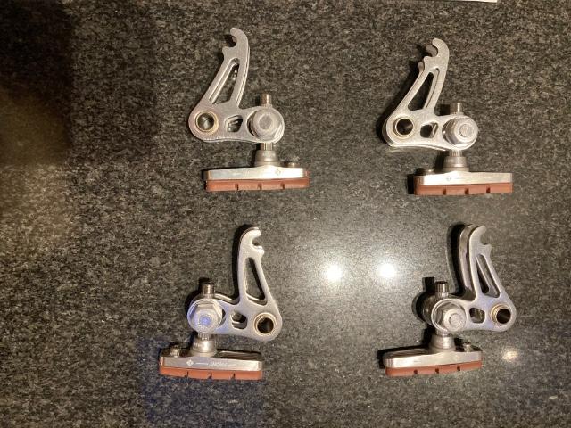

Jon - I've dug into the "things I bought but never fitted" section of my bike bits box! The Paul brake stuff was still there in a couple of plastic bags and with some rather quaint instructions on how to fit the springs without losing an eye. I've attached some photos - just drop me a mail to tony.barcroft@me.com if you're interested and we can sort something out.

tony barcroft2022-01-24 17:14:11
Sorry Jon - I had some more photos to show "what's in the bag" but I think I crashed the system uploading too many pics. Suffice to say that in the bag are all the bits to fit them (springs, bolts, washers, adjusters etc

tony barcroft2022-01-25 08:31:57
Jon - sorry to let you know - the ones i found in my bike bits box are actually "Velo Orange" not Paul.
https://www.ebay.co.uk/itm/Velo-Orange-Grand-Cru-Zeste-Max-Power-Cantilever-Brake-Set-Silver-/192137299079
Apologies for any confusion
