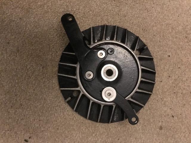

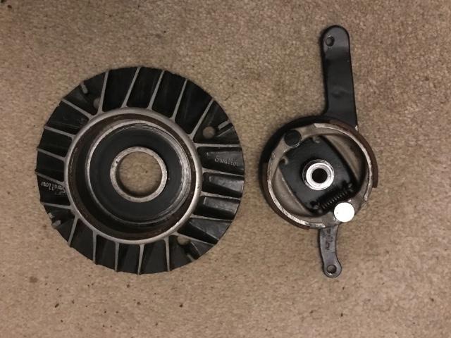

Mike Dunning2021-11-10 21:54:07
Hi Ted - I also have a Campy 8-speed tandem hub built into a 26" wheel. It's brand new and never been used. I've haven't tried to fit an Arai drum brake to it, but have a Swallow drum brake that is of a similar design to the Arai, but appears a little less bulky. I'll see if it fits the Campy hub and let you know the outcome. Happy to sell it to you if it solves your problem. I should add, I think my Canpy is also a 140mm.
Cheers
Mike Dunning

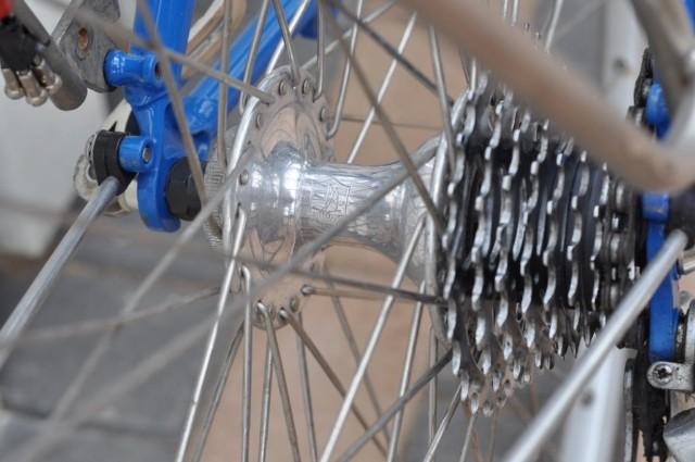

Michaela Buchholz2021-11-13 19:04:29
Hi Mike,
we have used the Arai on 140 mm hubs, but not on a Campy hub. Normally there is a washer on the left side at the axle that must be replace to use the Arai. I cant see it on your picture, and at no picture from Campy Tandem hubs. So it can be that you need a smaller nut to place the Arai.
Cheers
Jörg
