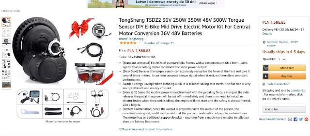

I ordered a kit from the Polish Amazon, and I think it is supplied from Germany.  The cost is about £300 which seems very reasonable to me.  See the attached.
My question is about how to use this engine.  I have a 36 Volt battery left over from my first kit, so it seems that the power will be both 250W and 350W.  There doesn't seem to be any setting where one sets the power output.  One can set the maximum speed, and by retaining the default maximum speed of 25 kpm, (rather than raising it) I am legal on that front.  I can set the torque responsiveness.  But no-where is there a reference to power rating.

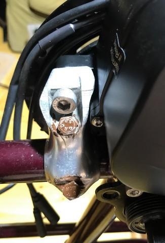

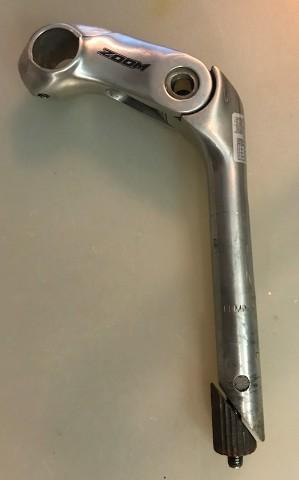

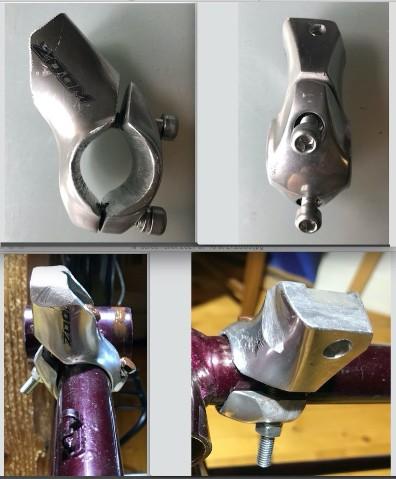

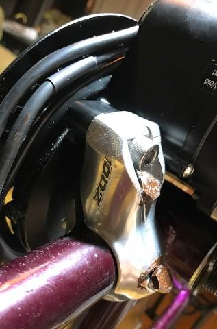

My kit arrived for me in Poland from Germany recently.  Although advertised as both 48v and 36v, the motor has a label on it, as shown, only saying 36v.  Curiously, the immaculate and never opened box stated that the contents were a Bafang MM.G250, which at first had me thinking I had been sent the wrong motor.  So maybe Bafang own Tongsheng.
In case it is of interest, I found a way to mount the motor on the front bottom bracket by cutting and filing an old quill stem to hold the motor steady.  The result is pretty sturdy and I think as good, or even better, than would be the case using the elbow provided for attaching at the rear (which I did not need to use).
I am not yet finished with the installation since I must switch the chain tensioner to the opposite side now that all chains run on the right hand side.

Stephen Barnes2021-07-18 20:26:02
Further shot

2021-10-23 02:26:56
As an alternative to fashioning an old quill stem to clamp the motor to the tandem boom bar, for possible inspiration have a look at the 'P' shaped clamp here used to clamp the motor to a recumbent trike boom bar. (in case the hyperlink subsequently goes dead, the website is eco-bike.com and search for trike boom clamp)
