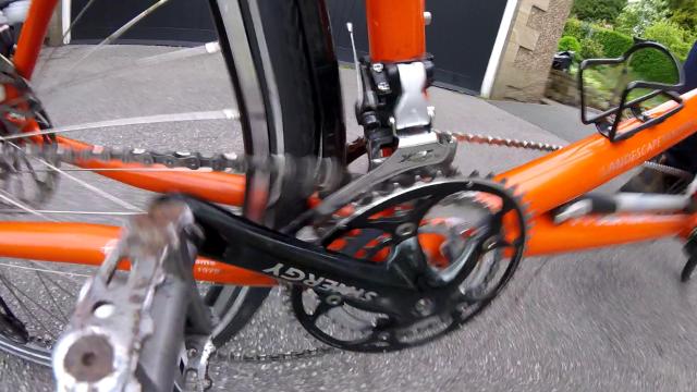

I've just renewed the drivetrain on our tandem (3x9), new chain, cassette and chanrings.  Timing chain is relatively new (5 years), timing chainrings, rear hub and bottom brackets 12 years old.  Drive and shifting are fine until some load is applied when, at some points, it sounds and feels like the chain is skipping - there's a loud crack and the cranks 'jump' a short distance.  To see if the chain was skipping I mounted a GoPro to film the cassette and chainrings and went through the video frame by frame.  The chain does not appear to be skipping (either riding up the teeth or changing cogs) and the cassette appears to remain 'in sync' with the wheel but there is a noticeable loss of tension with the chain going slack at the point at which the loud crack occurs - often when the cranks are horizontal (presumably max load).  Sometimes the chain derails from the chainring, sometimes not.  The cranks rotate noticeably more in a single frame when the crack occurs.  With amount of deflection on the video I'm surprised it doesn't always derail!
As mentioned, the drivetrain is new.  The freehub appears to be working ok and I can't detect any play in the bottom brackets.  The problem did occur when I just changed the chain and chainrings so I then got the new cassette but that didn't solve it.
Attached are stills of the cassette and cranks of the point where the crack occurs.
Any suggestions of other things to check?

Just a suggestion. Have you checked each individual link on the drive chain. Had the same problem on our Thorn Discovery the chain looked fine when stationary but one side of a link was snapped and the problems occurred as soon as we put load on. You have to check each link very carefully to find this particular problem.
