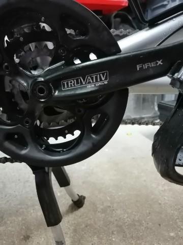

Now then folks, After our ride out today I decided to give the bike a clean. I noticed the Chain Guard seems to be broken in two places as can be seen from the photographs. I don't know how long it's been like this but I should get it replaced as soon as I can.
How do I removed this guard and what info/size etc do I need to order another one.

You need to remove and dismantle the chainset to remove the gaurd. If this is not something you are keen to do then you could simply break off the gaurd. Look at where it has snaped and score the lug/s that are still attached with a knife then snap it off. Chaingaurds are optional. Thay can help prevent the chain comming off but as you have a front changer this is not likely to happen. They also offer some protection against floppy trousers catching the chain. You can easily manage without it. Most bikes do not have them.
A replacement needs to have the same bolt-circle-diameter (pcd) and be the same size as your big ring and have the same number of mounting holes (4or5)
https://www.sjscycles.co.uk/search/?term=chaingaurd
Chris

Before now I have successfully tied the plastic back into place with string. I can't see the details of the break, but it all depends what final result matters most. The string was a very quick solution, has lasted well, and keeps my socks cleaner than they would be on that particular (single) bike.

Chris,
Thanks for your input. I have managed to find the issue and rectify it. After a blooming good clean I noticed the countersunk screws that scure the guard from the inside of the large ring. 2 screws were missing so a simple fix.. SJS Cycles were very helpful in pointing me in the right direction.
