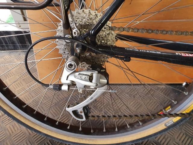

My wife and i are planning to LEJOG next year, we have been training hard and did plan on doing this year but hay ho that would be. We plan on using a Thorn tandem (see attached pictures) please could i ask if you think the bike is good enough, the rims are 48 SS spokes.

Surely the question is what do you doubt about your tandem to give you cause for concern that the tandem can not do LEJOG?
Hi Mark
Thanks for the responce, my concerns are one i dont know abut this model Thorn bike as i am not into Tandems, also i have been told its best to have disk brakes with a drag brake, i am not sure if i can fit a drag brake onto the bike. Dont know alot about the wheels apart from 48 spokes which to me is alot. Any helpw would be appreciated.
Spencer

Is this set up for you? it looks like a small frame that's been heavily extended for a steersman very much taller than the stoker. If you've been training hard but not on the tandem, then change that now and by next year you'll know how it goes.
It also looks as though the front wheel is smaller than the back but that is probably photo distortion.
If you have the time and are mechanically competent, of course it will get you from end to end. Other options might be faster or more comfortable but could be costly and until you've got some miles in on something you won't know what to look for. Thorn are a respected brand and the gear looks OK from what I can see in the photos. You might want to fit another bottle cage or two!

Hi All thanks for your great comments, do you think we would need a drag brake for LAJOG
Not sure if you can fit an arai drum brake on the rear (if you can find one) without changing the rear wheel, but an extra rim brake may just be possible. A couple of times in Scottish mountain rain our V brakes wouldn't stop us - though they did prevent acceleration and luckily the other traffic had taken refuge already. Better blocks (salmon koolstop) might help, if the levers and cabling work well too. But I wouldn't want to tour without a backup brake again.
Perhaps some koolstop salmon brake blocks would help?
A drag brake is always useful on a tandem. It won't stop you very quickly but is good for bleeding off speed on a steep or long descent without heating up the rims. If your hub is threaded on the non-drive side (looks like a sprocket or freewheel could screw on there), then you should be able to fit an Arai or similar drag brake. Arai brakes are no longer available new but you can occasionally ge a second hand one. There are alternatives available, I believe.
I assume from the lack of luggage carrying capacity that you will be overnighting at B&Bs, hostels or hotels, so you won't have the extra weight of camping gear. However it looks as though you and your partner are tall, so not featherweights added to which a Thorn tandem is quite a heavy bike in the first place. On long straightish descents the bike will build up quite a lot of speed (40+ mph) if left to run, which can be a bit scary and with very little chance of stopping quickly. If you want to bleed speed off on the descent, you are best braking quite hard for a short period with alternate brakes every so often which gives the chance for the rim to cool off somewhat befor the brake is applied again. You should definitely fit good quality brake blocks as already suggested. Oh yes and carry some spare ones with you!

There are lots of reasonable routes for this trip. We took a simple route in the opposite direction on our rim brake Dawes and only stopped for rim cooling once at on the A9 at Berriedale although this was also a chance to talk to some other cyclists. The Thorn we bought later has a drag brake which I like for saving my wrist from strain, parking and to reduce rim wear. For rides that even brush the Alps or Pyrennes the drag brake really comes into its own on routes with long steep descents and nowhere to stop and cool rims.
As your Thorn has 48 spoke wheels it may well have a Shimano Tandem hub with a thread on the left for a drag brake.
With a rim brake tandem you can take a serious amount of metal out of the braking tracks on a good length tour especially if it rains a lot and you use smaller roads. The easiest way to check thickness before you go is an Iwanson gauge made for dental work.
Certainly this frame doesn't look an obvious good fit for a tall captain and short stoker and if the history of the front seat post is unknown you might want to replace it making sure you get a robust and long one to have plenty in the frame.
You have the twin plate crown forks which are more comfortable than you would get with a disk brake fork.
