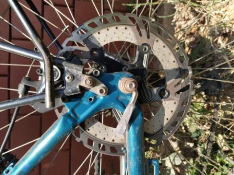

We've been through a few brake combinations and are reasonably happy with what we have...
Currently the tandem has 203mm rotors front and rear with TRP spyre callipers and sintered pads. With V-brakes on the rear for emergency/parking.
The rotors have aluminium heat dissipation fins which I was initially sceptical of, but they do get very hot and cool quickly.
You can see the abuse our disks get both from heat and the sintered pads in the photos.
We used to have BB7 with plastic knobs but we melted them, the TRP's are all metal.
We still have to stop and allow the brakes to cool on long winding descents, letting the bike run is not really an option as we'd easily hit +70kph.
