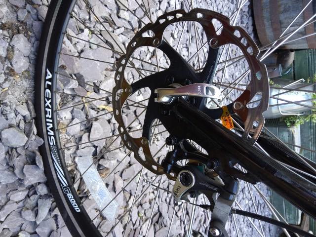

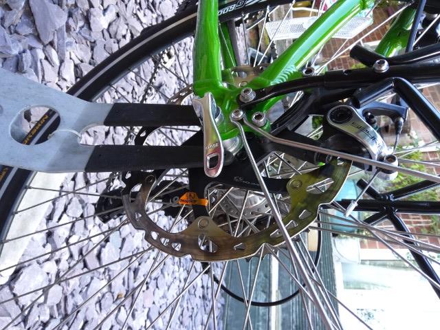

Hi everyone, thanks for all your comments, I wanted to post an update for the help of others coming across this thread.
My original enquiry was about upgrading the pads on my TRP Spires.
The answer to this one is simple, there are better pads out there.  A set of Discopads 'copper free' made a significant difference, they improved initial bite and overall power.
The rotors on the bike, 203mm stamped steel rotors, did appear to be getting very hot. We didn't experience fade but they where getting noisy on very steep descents.
Upgrade number 2 came in the form of Shimano XT Ice-tech 203mm rotors.  These are simply superb.  The brakes are powerful, smooth, quite and confidence inspiring.  Pilot Chris commented 'the brake are now what I expected them to be'.
Alongside the pad and rotor upgrades, correct setup I'm sure has been absolutely crucial.  Yes these brakes take ongoing tweaking, but they are certainly up to the job.
I get all the comments about hydraulic disks and understand people championing them passionately.  I would say that there will always be use case scenarios, whether that be cost, application, preference etc.
I wanted to work with what I had for now, it's really good to know that the Spires are able to deliver solid performance.  Whether fluid boiling in hydraulics is an issue or not I really don't know (beyond what I was advised at purchase), for now though cables are doing an excellent job.
2022-09-02 09:21:04
Sorry, can't work out how to put pictures the right way round
