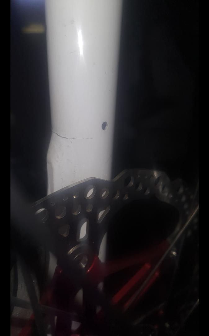

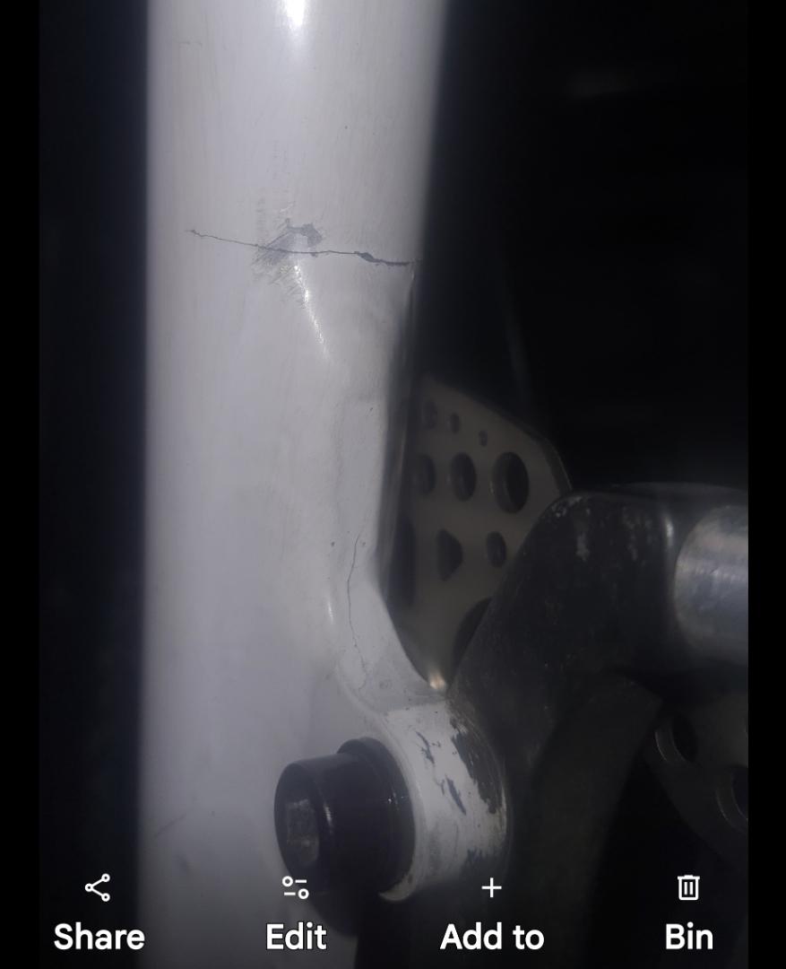

I was changing my disc pads and rotor this evening and noticed a stress fracture to my Cannondale fatty fork. There appears to be a crack spreading bilaterally from the upper edge of the IS disc mount involving about 180 degrees of the tube. I'm visually impaired but fortunately this was quite evident to touch which is how I noticed it. The front brake had developed a screach and judder, I was going to change the pads and rotor but I am guessing this is more likely the cause of the problem.
It's definitely terminal, I've included pictures and explanation mainly for people's interest.

you need a fork built for a tandem and a tandem with a disk. So unfortunately, it will be heavy, stopping a Tandem with a disk Brake puts a lot of stress on the lower part of fork around the area you have the crack.
At least one tandem specialist refuses to fit disk brakes on the front of a tandem (Thorn).
The force generated by the weight of two people,"the bending moment" I believe it is called is considerable and will do exactly what you have seen to a fork that isn't sufficiently robust. Some may think there is no fork that isn't sufficiently robust (Thorn).Obviously JD Tandems fit disc brakes to their Orbits. i am told that they have never had a problem so far. When I asked specifically if the fork had been designed for a tandem with disk brakes I didn't get a convincing answer, so I decided to go with a rear disk brake and a V brake at the front initially. Would like to go to disk but waiting to see how reliable the forks are over the long term.

There seems to be some incorrect information on this thread regarding our disc brake forks, which are designed and manufactured for tandem use, and weigh 1.4kg, available in 2 different axle to crown lengths.
We have supplied them to at least 2 customers with Cannondale fatty forks that have cracked in the same place as above, although the forks we have replaced had an 1/8" for steerer, whereas a Cannondale T2 is 1.5" so our forks won't fit.

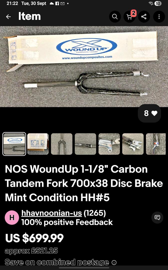

Carbon Fibre - interestingly Co-Motion offer a carbon fork on a tandem, I'm not saying this as fact BUT Co-Motion cite developing their carbon fork with a carbon specialist - from what I could find on the internet this seems to be Wound Up (please correct me if I am wrong).
Wound Up specifically state their Duo2 disk fork is Tandem specific (there must be some confidence in that this is specificity developed for tandems), quote from Wound Up website 'Amazingly light, yet plenty strong enough for the demands placed on it by two adult riders taking a steep downhill corner. Plenty strong for the torsional forces that it experiences when you brake sharply while it carries four hundred and fifty pounds. We know, because, in our testing, we make sure that it will handle way more than you’ll ever throw at it in its intended use'

I have never run over a 203mm rotor as a front brake, I do not believe any manufacturers sell them as OEM and I suspect the Cannondale cracking issue explains why.
