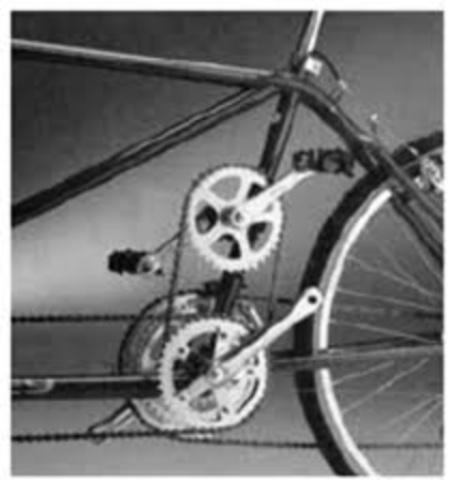

2020-08-18 12:35:15
The other option - which we started out with - is a set of 'kiddycranks' on the rear seat tube, connected to the left-side rear crankset (ie making that a double), using the same sized ring as fitted to the kiddycrank set. You can move the kiddycranks up and down the seattube to suit various child leg lengths until they're able to reach the main set of pedals.
Mr Nicholas Dover2020-08-18 14:09:13
That IS clever!!
